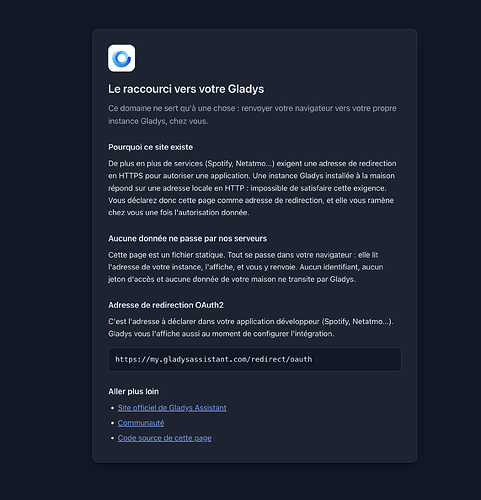

I will set up an official HTTPS redirect URL, hosted by Gladys, on the same principle as what Home Assistant does with my.home-assistant.io.
The principle:
  1. This official URL (in HTTPS, therefore accepted by Spotify) is the one you declare in your Spotify app; no need for a certificate or a domain name at your end.
  2. After your authorization, Spotify redirects to this page, which simply redirects your browser to your local Gladys, with a confirmation screen clearly indicating the address you will be redirected to.
  3. Your instance completes the exchange itself and stores the tokens locally.
Important point on privacy: this page is entirely static, with no server behind it. Your Spotify credentials, access tokens, and data never pass through our servers; the page only does a redirect in your browser, exactly like Home Assistant does.

There you go, available at https://my.gladysassistant.com/
Now, there’s just a small adjustment needed in Gladys’ code :slight_smile:

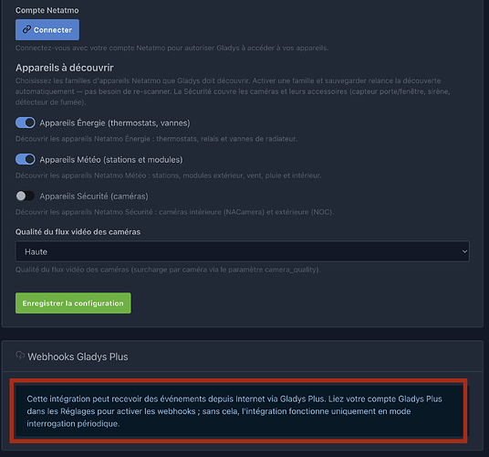

So could the Netatmo service be reviewed to use this route? Or have the option to specify the route like for Spotify?
Or did I not understand correctly? :smiley:
No, it’s a completely different mechanism. :slightly_smiling_face:
Here, I’m simply proposing a redirect URL: everything happens in the browser. It’s only used for the OAuth flow to redirect the user to their instance after authentication. It’s free for me, so even if one day we reach the same scale as Home Assistant, I can continue to offer it without any problems.
For Netatmo, it’s a different architecture. Webhooks go through the Gladys Plus servers, which maintain a permanent WebSocket connection with each user’s local instance to transmit events in real time.
This infrastructure has a cost (servers, persistent connections, bandwidth, etc.), so it’s not something I can offer for free. :slightly_smiling_face:

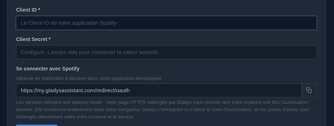

@pierre-gilles, I confirm that the https link works very well.
@l.dolle, when the update is released:
The https page will then open and you can validate. The account is connected
You can check if you want one of your devices to open with the Test Connection action
