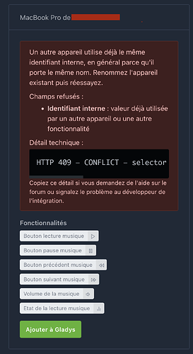

I wanted to integrate Spotify:
Is there no way to have a single selector (uuid)?

So selector = slugify(device.name), without any deduplication, even though the column is unique: true (server/models/device.js:32-36). The UNIQUE constraint is skipped, Sequelize throws a SequelizeUniqueConstraintError, and errorMiddleware.js:42-49 turns it into a 409 on the selector attribute — exactly what the forum member sees.
His Spotify Connect device is named « MacBook Pro de … » → selector macbook-pro-de-..., which already exists for him (probably another device with the same name: a Chromecast, an AirPlay, a device from another integration, or a previously added and renamed Spotify).
