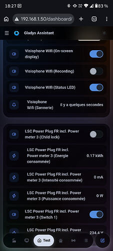

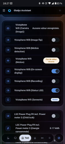

Hello!
I have an issue with the ‹ doorbell rings › action.
The action appears correctly, well detected but the scene does not trigger…
Yet, it worked!
Nothing special in the logs. I have the impression that it’s rather on the core side…
[2026-09-03T16:26:54.376Z] [INFO] [tuya] [Tuya][push] device=bf8a5bf8acc4540a41rere local push published 1 change(s)
[2026-09-03T16:26:54.414Z] [INFO] [tuya] [Tuya][push] device=bf8a5bf8acc4540a41rere local push published 1 change(s)
[2026-09-03T16:26:54.520Z] [INFO] [tuya] [Tuya][push] device=bf8a5bf8acc4540a41rere local push published 1 change(s)
[2026-09-03T16:26:54.718Z] [INFO] [tuya] [Tuya][push] device=bf8a5bf8acc4540a41rere local push published 1 change(s)
[2026-09-03T16:26:55.913Z] [INFO] [tuya] [Tuya][media] doorbell_pic event fired (device=ext:ext-terdious-gladys-tuya:device:bf0e59548489fcb4ea62of)
[2026-09-03T16:26:57.110Z] [INFO] [tuya] [Tuya][media] doorbell_pic snapshot published (device=ext:ext-terdious-gladys-tuya:device:bf0e59548489fcb4ea62of)

Thanks for the logs, they say it all, and no, it’s not on the core side.
The scene is indeed triggered (your capture « Ring: a few seconds ago » confirms it). What fails are your three actions « send the image »: the integration was pulling the ring before finishing downloading the photo (1.2s difference in your logs). The scene therefore requested the image too early. Before, you actually retrieved the photo from the previous ring without noticing; this morning’s update restarted the container, cleared the cache, and the error became visible.
Fixed in 1.13.2 (available in the store in about an hour): the photo is published first, the ring second, and an image request during download waits instead of failing. After the update, press the doorbell once to prime it, then the scene should send the correct photo of the visitor.
