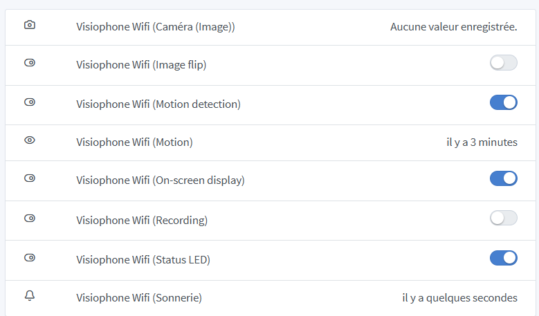

I updated and restarted the container and… It’s pretty cool:
Fully functional!
Edit: Removing the device wasn’t enough. I had to delete it, restart the container, and add it again. The « doorbell » feature appeared « later ».

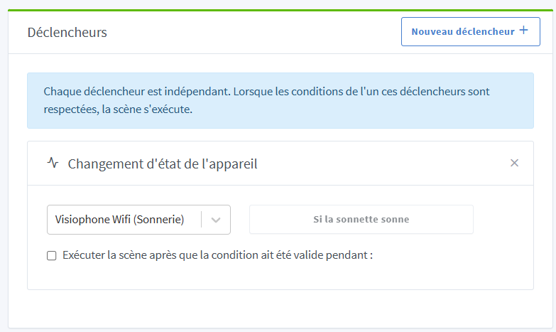

I love it!!^^ And have you tested the scenes? I tested in MQTT simulation, but as it’s a new trigger, a real usage test would be better ^^
So yes indeed, I haven’t yet reported this issue to @pierre-gilles, but there’s no loader on external integrations while waiting for feedback from discovered devices!! So we think it’s fast, but as Tuya does a UDP scan, it can take 30s… sorry
So with all that, I don’t know where we stand anymore ^^ Do you now have all your Tuya devices??
Yep, scenes tested and functional (button, motion detection - The neighbors must be wondering what I’m doing walking around my doorbell at 11 p.m…).
There must be a minimum delay between two detections (about a minute it seems) but it matches exactly the behavior of the Tuya app!

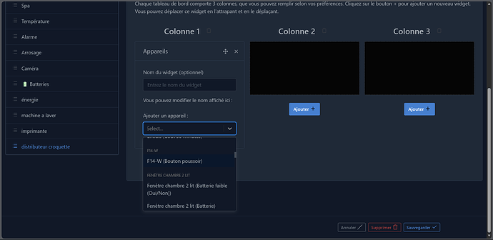

My son has an RGB LED strip LSC-TUYA if you’re interested in adding it (but he’s not asking for it yet)…
Welcome back, I’ll talk to Claude about it!

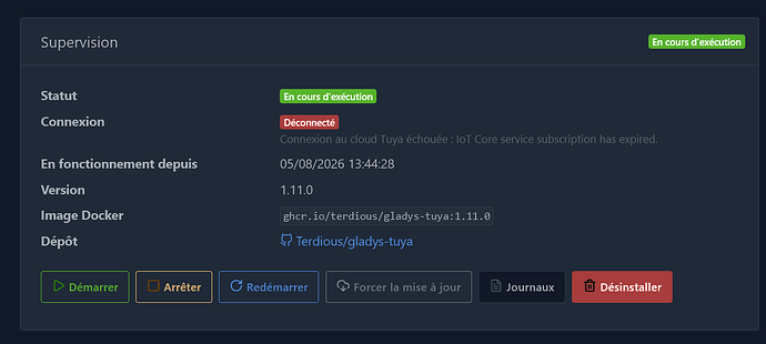

I installed the external app, created the Tuya dev account, and retrieved all the configuration parameters. I also linked my Smartlife account. But the connection is not working.

[2026-08-05T11:39:32.008Z] [ERROR] [tuya] Error connecting to Tuya: IoT Core service subscription has expired. Error: IoT Core service subscription has expired.

I saw the supported devices, I have an LSC camera from Action and a cat feeder. Do you think I could get them in Gladys?
Hi @elfedagger,
Good news: your configuration is correct, and the integration works (it is properly connected to Gladys).
The issue comes from the Tuya cloud itself:
« IoT Core service subscription has expired » (code 28841002)
On the Tuya IoT Platform, the IoT Core service is offered as a free trial
limited in time (1 month initially). Once expired, Tuya rejects
all API calls from the cloud project — so no device accessible,
regardless of the integration used.
The good news: the renewal is FREE and immediate.
  1. Go to https://iot.tuya.com/ and log in.
  2. Open Cloud → Development → your project → « Service API » tab
    (or directly Cloud → Cloud Services → IoT Core).
  3. Locate « IoT Core »: its status should be expired.
  4. Click on « Extend Trial Period » (or « Free Trial » / « Subscribe »)
    and confirm — it’s free, extended for 6 months, effective immediately.
  5. Go back to Gladys: the connection will automatically restore
    (otherwise, click on « Restart » in the Supervision card).
Note: this extension must be renewed every 6 months, Tuya does not
offer a permanent free subscription. Set a reminder:
when the trial expires, your Tuya devices will suddenly disconnect.

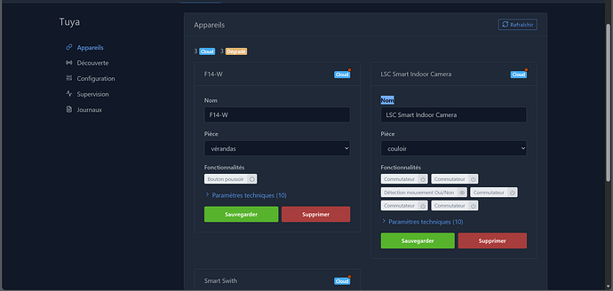

I extended it for 6 months and they told me my request will be reviewed. I’m waiting for Tuya’s response.
Normally it’s quick ^^ For info, it took me less than 1 hour

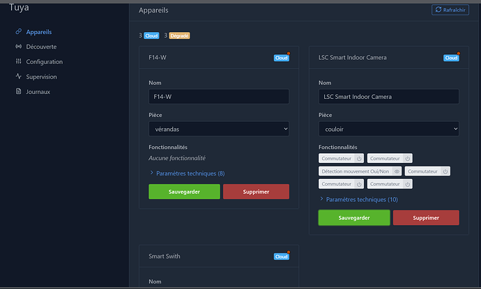

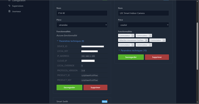

ok, I see my 3 devices. The camera has multiple connector features and one motion detector. F14 is the kibble dispenser.
Thanks for your help.
I have this info about the distributor in the logs, I didn’t find the code you’re asking for.
[2026-08-05T14:09:13.775Z] [WARN] [tuya] [Tuya][poll] local mode on but LAN info incomplete for device=bffc52d5f1c50572406mee (ip/protocol/local_key missing) — using cloud; set the IP to enable local
[2026-08-05T14:09:35.748Z] [INFO] [tuya] [Tuya][localSession] device=bfc15bb8b2ab6c69f5wgtr connected (192.168.1.139, 3.3)

@elfedagger,
Thanks for your feedback, it was very helpful :folded_hands:
:warning: First, an important point: I edited your previous message to
replace your screenshot. It revealed three pieces of information
that are better not to share publicly:
• LOCAL_KEY — this is the key that allows you to control your device directly
on your local network. It’s a secret, just like a password.
• DEVICE_ID — your device’s identifier at Tuya.
• CLOUD_IP — and this is the most sensitive: it’s the public IP
address of your Internet connection, so of your box. Published in plain text,
it allows someone to locate and target your home.
Nothing serious here, but the reflex to take: before posting a screenshot
of the « Technical Settings » or logs, mask these fields. If you
want to be completely at ease, you can delete and then re-pair the
dispenser in the Smart Life app: this generates a new local key.
:tada: Good news next: thanks to your report, version 1.12.0
just came out and adds support for Tuya kibble dispensers. It will be offered in your Gladys within about an hour
once the store references it.
Your F14-W should then expose:
• Distribute — a button that gives a portion (usable in a scene,
for example every day at 8:00 a.m.)
• Last distributed quantity
• Slow distribution
• Indicator light
• Battery
Steps to follow once 1.12.0 is installed: go to the Discovery tab and click on « Refresh ». Your dispenser, already created, will display an « Update » button: one click is enough for it to retrieve its new features. Nothing to delete.
:wrench: A small favor to ask, if you don’t mind
For now, the dispenser only works via the cloud. The local (LAN) mode is not yet active for this type of device: the internal command numbers vary from one model to another, and I have no real data to rely on.
I just added an automatic log in this version. Once in
1.12.0, with the local mode activated and your dispenser created, you will find
in the Logs a line like this:
[Tuya][poll][local] device=bf15… DPS snapshot: 1=… (UNMAPPED) | 3=… (manual_feed) | …
If you copy it here (the one that contains « DPS snapshot »), I’ll activate the
local mode for your model right away :slightly_smiling_face:
Two other improvements from our exchanges:
• Unrecognized devices are now reported at each discovery,
with the list of their unsupported commands — no need to
restart the container to find them, as was the case
for you. It was my side that was stuck.
• The message displayed when the IoT Core trial expires now explains
how to extend it for free, instead of sending the raw
message from Tuya. Remember to renew it in 6 months!
The integration documentation has also been updated: it finally lists
cameras, doorbells, and dispensers, and warns about the IoT Core trial.
Thanks again for your feedback :ok_hand:

The distributor does not display everything it should, only the distribution button.
For what you asked me, I found this.
[2026-08-05T18:08:07.095Z] [INFO] [tuya] [Tuya][poll][local] device=bf15bc151aba2c4bb4bjap DPS snapshot: 4="standby" (UNMAPPED) | 106=2957 (UNMAPPED) | 108="" (UNMAPPED) | 114=0 (UNMAPPED)
