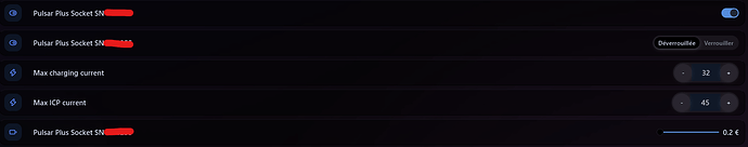

I am currently facing a limitation for displaying and modifying the value on the homepage.
Here is an image to illustrate my problem.
My problem is as follows: I cannot modify the last field with a step of 0.0001, which is the price of electricity. The step is limited to one.

Fix proposed here fix(dashboard): honor the device feature step on the slider and numbe… by cicoub13 · Pull Request #3114 · GladysAssistant/Gladys · GitHub
In the meantime, you can cheat by using this type:
type: DEVICE_FEATURE_TYPES.ELECTRICAL_VEHICLE_CHARGE.TARGET_CURRENT,
unit: DEVICE_FEATURE_UNITS.EURO, min: 0, max: 5, step: 0.0001,
Thanks for the info and your fix. I’ll wait for the new version as your modification has just been merged.
