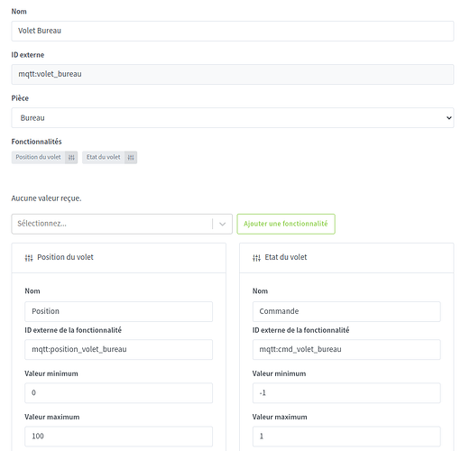

@gaelbillon Here are some explanations for the Freebox module in Node-RED
First, you need to create an MQTT device with the features Shutter Position and Shutter State

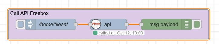

Below is a first Flow to test the connection and get the return of all your security pack devices.

```Below is the flow of a shutter

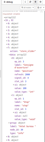

Hi @_Will_71,
I’ve started looking and already have questions; for info I’m not a developer.
On the 1st Flow, could you please show me what you put?
Thanks

For that the first flow I gave you will let you find these values.
If you run the flow here’s what you’ll get
If you expand it you’ll find all your devices
My example shutter is at value 7 in the table
Here’s how to form the msg.url
/home/endpoints/node_id/ep_id
With node_id the identifier of your shutter — here my shutter is 30 => value to retrieve from the payload obtained above. So you must modify it according to the value you have for your shutter.
And ep_id the identifier of your function — here I use the position feature which has the identifier 3 => this value normally doesn’t need to be changed; on my 6 shutters this identifier is the same.
