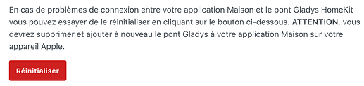

The PR to reset the HomeKit bridge from the integration’s configuration page
This should simplify the procedure that @cicoub13 described a little earlier.

Tested this morning with two scenarios:
  • removal of the bridge in Home on iPad, reset on Gladys then adding the bridge. Everything works :white_check_mark:
  • reset on Gladys, then removing/adding the bridge in Home on iPad. Everything works :white_check_mark:
Thanks :muscle:
This feature is available in Gladys Assistant 4.25, thanks to @bertrandda for development and @cicoub13 for testing!
