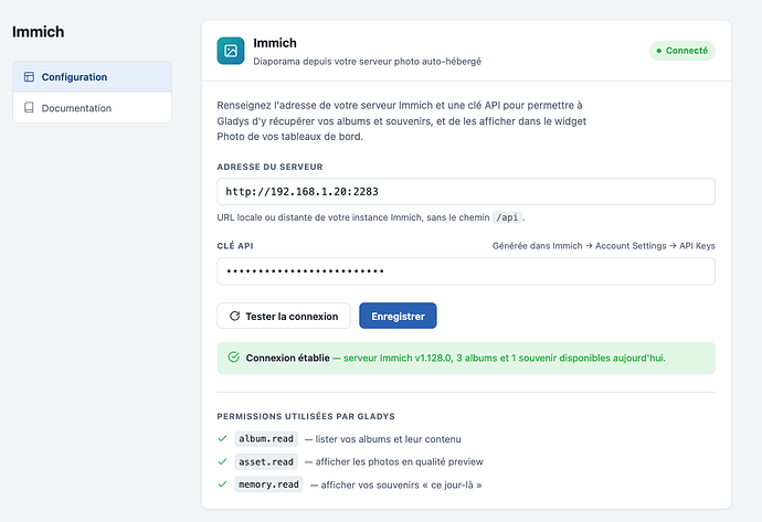

  • New Immich card in the list of integrations.
  • Config page asking for Server URL + API Key.
  • “Test Connection” button → calls GET /api/albums to validate URL + key, and
    returns a clear error if failed (unreachable URL, 401 invalid key).

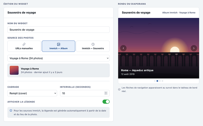

3.2 Widget Configuration (By the User, When Editing the Dashboard)
The Photo Widget gains a choice of source mode:
  1. Manual URLs — current behavior, unchanged (full backward compatibility).
  2. Immich — Album — a dropdown lists the albums (via GET /api/albums);
    the user selects one.
  3. Immich — Memories — displays photos returned by GET /api/memories
    (“X years ago, on this day”).
Existing options are preserved and applicable to all modes: framing (cover/contain),
slideshow interval, showing/hiding captions, widget title.
For Immich modes, the caption can be auto-generated from the asset metadata (date + location) instead of manually entered.

The second iteration (0.1.2) is ready and tested on my end.
  1. Create an API key in your Immich server
  2. Fill in the fields in the Immich external integration
  3. Save, test the connection and refresh the slideshow
  4. In the « discovery » tab, save the device (change its name if desired). You can choose the room in the « Devices » tab
  5. You need to add an… « Immich camera » in the desired dashboard and you’re good to go!
