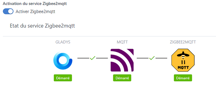

The Zigbee service is properly activated
