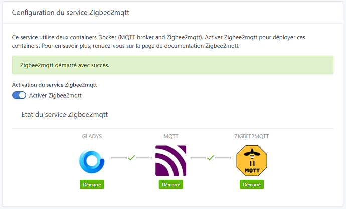

I just bought various Tradfri (Ikea) modules, as well as a CC2652 dongle from Slaesh (received today).
I’m having trouble pairing my Tradfri lamps/switches/gateway with Gladys.
Everything is well configured and functional, but I can’t detect my devices.

For the record, I finally managed to connect and configure my Tradfri by installing the Gladys image again.
I connected a screen/keyboard to my pi to view the configurations/logs as per the various posts, but nothing worked.
PS: For information, I was indeed using the latest official image from the website, pi in lowercase, …
When I installed Gladys last week and started configuring my users, rooms, etc.,
I started the installation of ZigBee2MQTT, but without having a USB stick.
In my opinion, the containers were generated with a bad configuration, and even though I selected the correct location, the configuration did not change.
