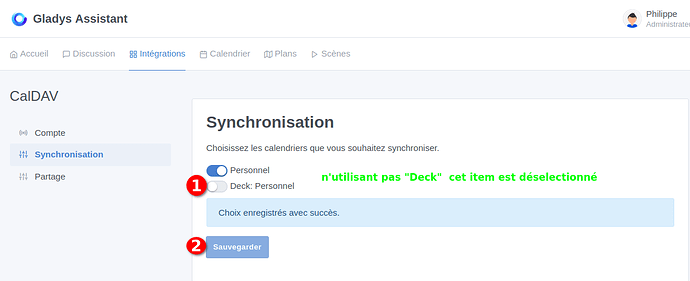

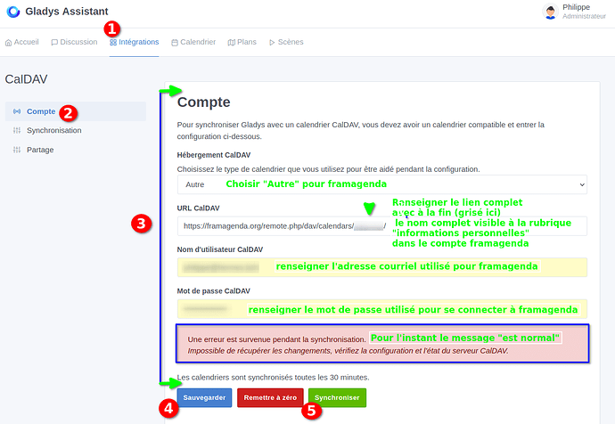

I use Framagenda daily, so having the « voir » explicitly in the « Calendar » under « Integrations » would be great. In the meantime here are a few screenshots to avoid fumbling, save time, and prevent error messages visible on the sync and via the command:
docker logs gladys
Then select the « Synchronization » option on the left, uncheck « Deck » then save

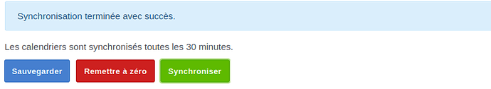

Go back to the Account option, synchronize .. no more error.

Hello. Everything is working perfectly. A big thank you for this intuitive tutorial. Julien
