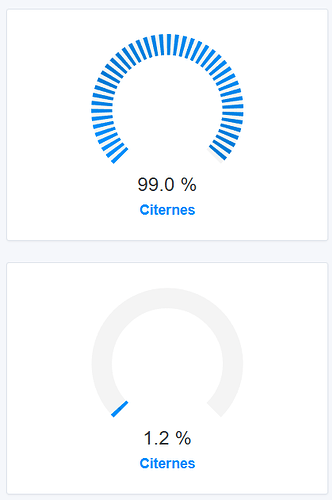

I finally (re)put back into service my system for measuring the amount of water remaining in my tanks and have a few widget improvements to request.
Would it be possible for the name to be editable or for the feature to be shown rather than the device? Here, I can’t tell the two tanks apart on the dashboard:
On mobile, the widget prevents scrolling. I’ll explain… If I place my finger on the widget, it’s impossible to scroll the page up or down — it’s not touch-responsive.
Would it be possible to improve this in the next UX update?

I have exactly the same problems as you: not possible to rename (well, I only have one tank) and a scrolling problem on mobile: if your finger is on the widget the screen doesn’t move.
Thanks for your feedback @GBoulvin !
It’s implemented in this PR:
master ← cursor/gauge-widget-improvements-0bfc
ouvert 04:25PM - 03 Jul 26 UTC
## Context
Forum thread: https://community.gladysassistant.com/t/jauges-amelior… ations/10058
Two UX issues were reported on gauge dashboard widgets:
1. **Indistinguishable labels** — when multiple gauges use the same device (e.g. two MQTT water tanks), the widget only showed the device name, making it impossible to tell them apart on the dashboard.
2. **Mobile scroll blocked** — on mobile, placing a finger on the gauge widget prevented scrolling the dashboard page.
Neither issue had been addressed in the codebase yet.
## Changes
### Editable widget name
- Added an optional **widget name** field in the gauge edit form (`box.name`), consistent with other dashboard widgets (scene, energy consumption, alarm, etc.).
- When set, this custom name is displayed as the gauge label.
### Smarter default label
- When no custom name is set, the gauge now uses `getDeviceName()` instead of always showing the device name.
- For integrations like MQTT (where users often have many features on one device), the **feature name** is shown automatically so tanks/sensors can be distinguished.
### Mobile scroll fix
- Added CSS on `.gauge-chart` to allow vertical page scrolling when the user touches the gauge:
- `touch-action: pan-y` on the chart container
- `pointer-events: none` on the ApexCharts canvas/SVG (the gauge is display-only, no interaction needed)
## Translations
Added `editNameLabel` and `editNamePlaceholder` keys in `en`, `fr`, and `de`.
## How to test
1. Add two gauge widgets bound to different features on the same MQTT device.
2. Verify each gauge shows its feature name by default.
3. Edit a gauge and set a custom widget name — verify it overrides the default label.
4. On mobile (or mobile emulation), scroll the dashboard with a finger starting on a gauge widget — the page should scroll normally.
