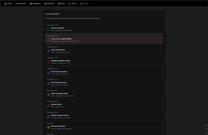

Here’s a mockup to make it clearer:
@pierre-gilles: I hope I was clearer than for my first request. :slightly_smiling_face:
Perfect, thanks :slight_smile:
Your first request was clear but as the topic evolved, it no longer was! Now it’s perfect :ok_hand:

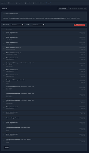

I wanted to give you an update tonight but didn’t have the time, I’ll do it tomorrow night

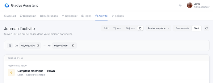

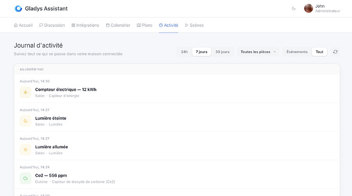

Edit: here are some screenshots anyway
A complete preview of what I’ve added
The ability to filter by type
By date
Or a standard search

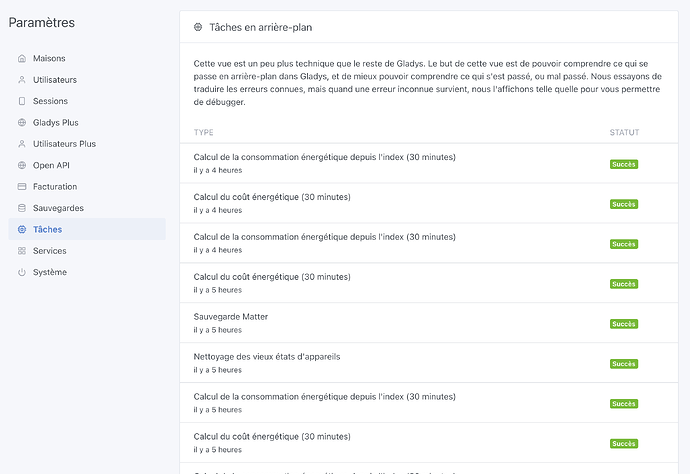

I see that you’ve chosen to mix information from sensors with more “system” information. Doesn’t that create a bit of redundancy with the “Background Tasks” view?
I know it’s possible to filter by type, but I’m afraid that, by default, this view might seem a bit too technical and deter some users. Given its location in the interface, I think it would benefit from being as user-friendly as possible, with information that’s truly useful and actionable on a daily basis.
I wonder if the very technical events wouldn’t be better placed in the “Background Tasks” view, so that this one remains more usage-oriented.

The « Background Tasks » page can also evolve, clearly :slight_smile:
I found the sensor display much clearer in the mockup. The title was customized by device name, for example, « Living room shutters closed, » vs. « Device state change, » which isn’t very descriptive :slight_smile:
It’s just formatting, and as explained, I’m just at the beginning, so there’s still work to be done.

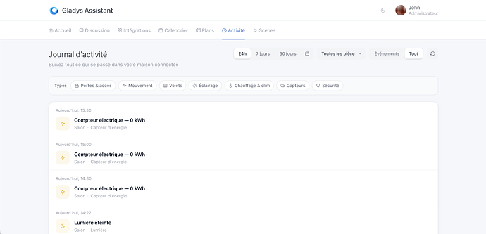

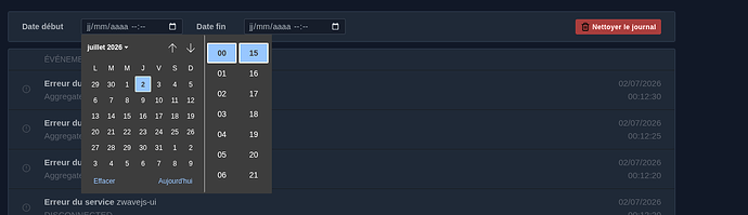

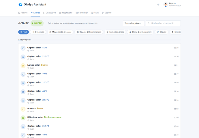

I asked Cursor Agent in Auto to develop the feature, and it came up with this in one go:
We can iterate on it, but I find it very clean.

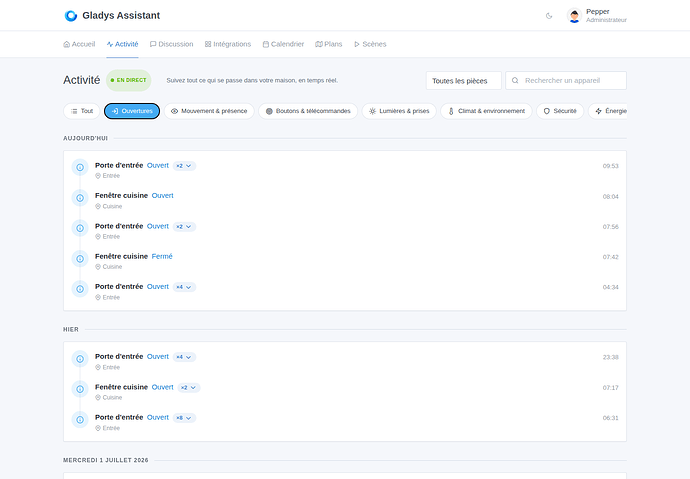

By the way, I also ran Fable 5 on it to compare the results :smiley:
The version of Fable 5 is less „design“ but more integrated with the patterns we already have in Gladys:
A mix of both would be ideal

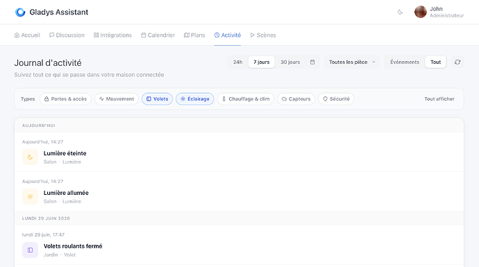

Yes I agree! I think the Cursor version is cleaner and we can just ask it to add more elements:
  • Be able to view specific dates
  • Filter by device type
By date, it offers this:
Hyper clean the selection of device categories:
The big advantage is that since this view remains focused on the « business usage » part and not on Gladys’ internal logic, there’s almost no backend code in the PR, and no data model changes. It’s all frontend.
So it could go out quite quickly. We can iterate on it, or even completely change tack, without consequences, because the data remains the existing data!
I really like it anyway :slight_smile:
I prefer Fable 5, we have more « simple » info on screen, it’s more condensed and I find the flow more readable. Live filters are nice but they take up a lot of space, and if you have to swipe right for 10 seconds to get the right filter, it’s annoying.
The screenshots were not taken at the same resolution, so the amount of information displayed is not really representative. :grinning_face_with_smiling_eyes:
For my part, I have a preference for Cursor!

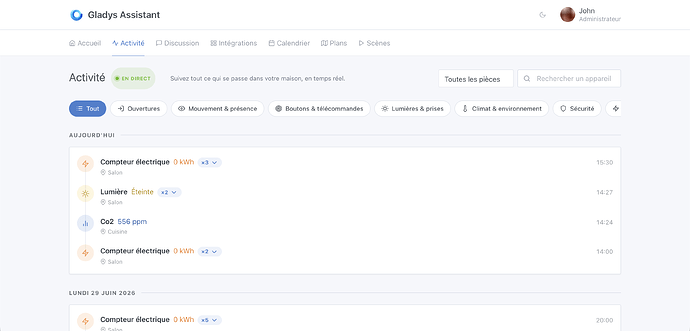

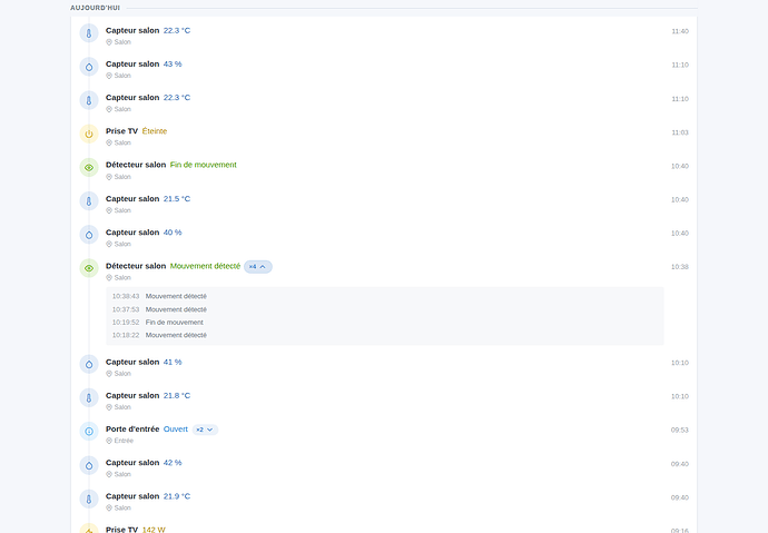

Quick comparison of the two versions on my MacBook Air screen:
Fable 5
Actually, what helps a lot here is that Fable groups consecutive events.
It’s true that when I tested it myself, the Fable version is super pleasant :smiley:
Cursor:
