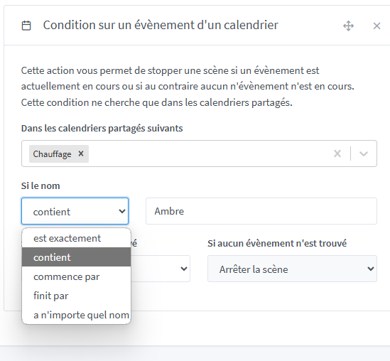

Dropdown list of an incomplete condition?
Hello
a silly thing
in this list it’s missing the item — it doesn’t include what would allow activating the heating in eco mode when it’s not necessary, for example
thanks
I’m coming back to this
Because I don’t know what to do about my heating: I would like a minimum temperature of 16 degrees, but with the scene system that doesn’t have an « else » I don’t see how to do it
I managed to make a neat setup so that the heating is activated from the calendar, but without that condition I’m forced to make the calendar fully filled even though it’s only when there’s nothing

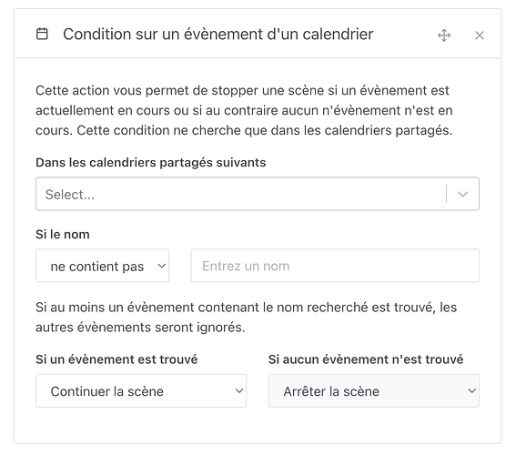

Okay, I’ve turned the question inside out and it seems more logical as you say :smile:
Imaginary scenario
Let’s imagine I want not to heat my home when it’s a Tempo Red day — I’m going to set up a scene that heats every day with the following action
Everything works perfectly; on blue/white days, the scene continues because « an event that does not contain red was found ».
On a red day, the scene stops because « no event that does not contain red was found » :exploding_head:
Now, if I add a morning appointment in my « RDV docteur » calendar, the expected behavior is that the scene still stops.

For info, the final version looks like this :
