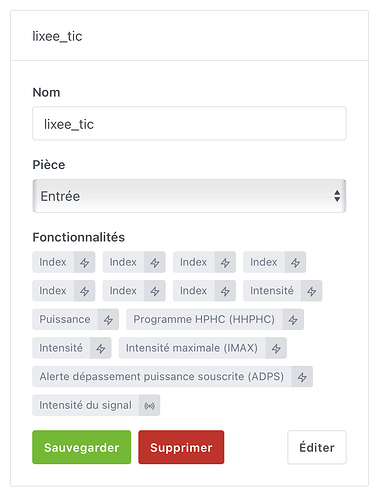

When I add it in Gladys, I don’t see the « Lixee-specific features Â» that @_Will_71 had added in 4.49 : Gladys Assistant 4.49 : DĂ©clencheurs avec dĂ©lai dans les scènes!

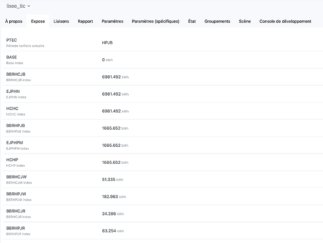

I see indexes all with the same name, quite difficult to distinguish:
On the Zigbee2mqtt side, I see this:
With this expose:

Maybe these features should be differentiated as well, at least give them a custom name, because in the UI it’s impossible to tell them apart:
By the way, I’m surprised there’s no « total consumption Â» and that it’s necessarily broken down into consumption periods ^^
it’s normal, the total is either base (a single index), or HC+HP (off-peak + peak, 2 indexes), or the sum of the 6 indexes of Tempo. There is no sum for the total consumption because EDF (or ES in my case) does not bill a total but relies on the indexes to apply the appropriate tariffs.
For info, your Linky is in Historical mode, in Standard mode the names are different again.
Hello, indeed the features are different in Standard mode with explicit descriptions: EAST is the total consumed (sum of the 6 rates), SINSTS the instantaneous. Note: my Lixee needs several pairings before becoming Standard. It appears to be in Auto mode (History/Standard) but it should be possible to force it into one of the two modes
