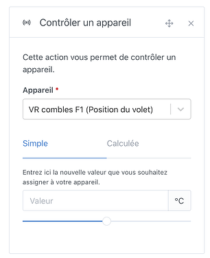

Wrong unit to control a roller shutter/blind
for now it’s a °C but a % would be preferable when you want to control a roller shutter in the scenes :
