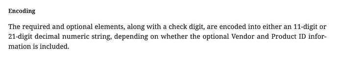

Indeed, I went to read the Matter documentation and the pairing code can be 21 digits! I didn’t know :smiley:
In fact, the pairing code can contain the « vendorID » and « productID » which are optional:
I’ll modify Gladys so we accept 21-digit codes, but in the meantime, if you’re feeling playful, either you recalculate the 11-digit code from the 21-digit code, or if you modify the page’s HTML you can remove the pattern required in the field — but I admit that’s a bit of a hack :joy:

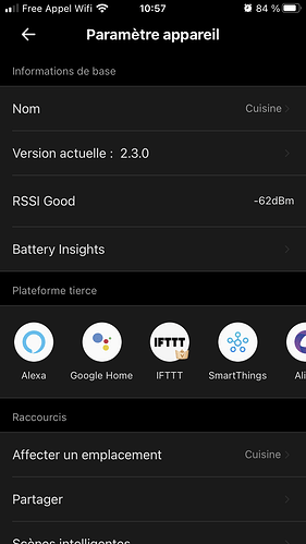

In the Sonoff app, do you have the ability to rename each sensor individually?
Gladys retrieves the Matter name of each device, so in principle, if you change the name in the manufacturer’s app, it should automatically be reflected in Gladys.

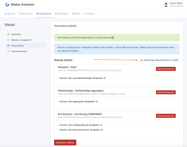

If that’s not the case, could you send me a screenshot of the Sonoff app so I can see what information is displayed?
And as a bonus, if you can send me that JSON file that would be great :slight_smile:

The modules already had an identifiable name but the information is not coming through. In the case of the JSON file the extension is not accepted here and it has more than 18,000 lines so a copy/paste would probably not be advisable.
Can you upload it somewhere (for example: https://pastebin.com/) or to the cloud of your choice and send me the link privately? :slight_smile:

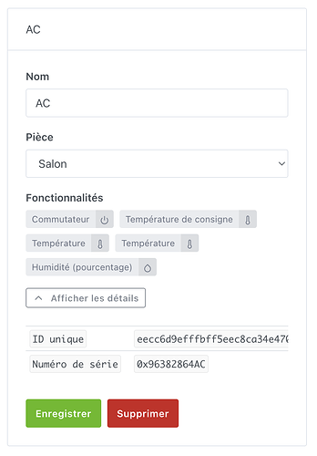

The MAC address is not exposed by your device in Matter, however the « Device ID » field seems to be sent :slight_smile:
I will display 2 new attributes in the interface:
  • Unique ID
  • Serial number
These attributes will be hidden by default so as not to clutter the interface, but visible with a click :slight_smile:
The PR :
It’s live in Gladys Assistant 4.59:
