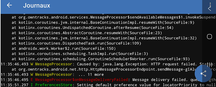

The logs on the phone:
Hi @Jluc :slightly_smiling_face:
Could you export all the Owntracks logs and send them to me by email?
The screenshot doesn’t show enough information to understand what’s happening.
I’d also appreciate screenshots of your configuration. If you could attach them to your email, that would be perfect. Thanks! :slightly_smiling_face:

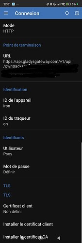

Can you share a screenshot of your configuration here? (make sure to hide the API key in the screenshot, or otherwise send me the screenshot privately)

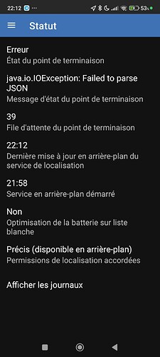

I have the same problem on Android. I changed my key, but the issue persists. I uninstalled OwnTracks and reinstalled it, but I still get the same message. This has been going on for a month, or a little more. Everything was working fine before. Here is my screenshot:
If this can help move things along, here is the error:
