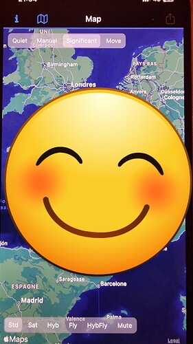

  • Make sure the mode is set to « Significant changes Â». I recommend reading the Owntracks documentation which is very explicit on the subject: Location - OwnTracks Booklet
iOS defines a Significant location change as traveling a distance of at least 500 meters in 5 minutes. This mode allows the app to run in background and minimize the power consumption.
This standard tracking mode reports significant location changes only (>500m and at most once every 5 minutes). This is defined by Apple and is optimal with respect to battery usage.
As mentioned, on iOS, the app won’t wake up at regular intervals, but on large changes of position — it’s done automatically by the OS so as not to wake apps too often and thus save battery.

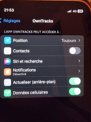

Here are the details :
everything seems correct to me though :thinking:
And can you confirm that the app isn’t being force‑closed by your wife and that the phone isn’t permanently in battery saver mode? (On the screenshot that’s not the case, but I don’t know her habits)
