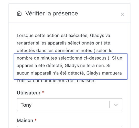

@Romuald_Pochet I saw your PR, the problem with your approach is that detection is going to be too slow!
The point of using a trigger is that the user is set as « home » instantly, and not via a scene executed periodically.
Absence detection, by nature, can only work via a periodic approach (we check every X minutes), to allow some leeway if the sensor isn’t seen once but is quickly seen again.
The scene action even specifies this:

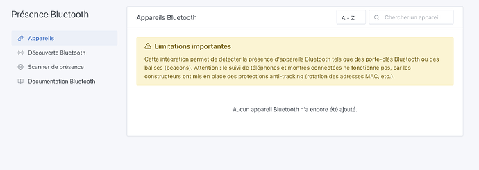

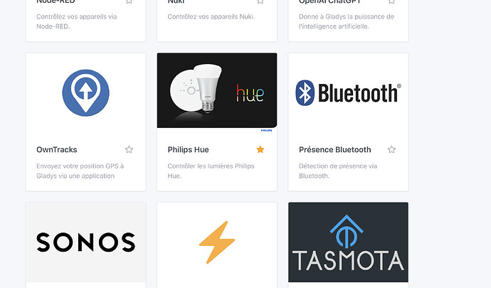

I see this integration is often misunderstood so I renamed the « Bluetooth » integration to « Bluetooth Presence »:
And inside the integration I added a small message to make it clearer:
The PR: Bluetooth Presence : Make integration more clear for new users by Pierre-Gilles · Pull Request #2490 · GladysAssistant/Gladys · GitHub
This fix is available in Gladys Assistant 4.71 :
