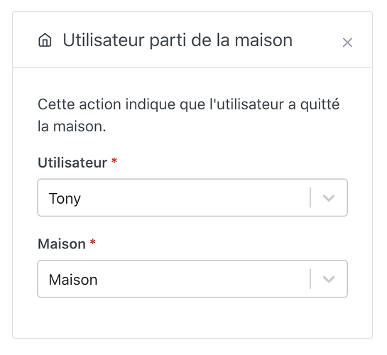

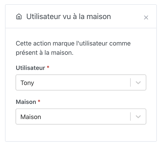

I’ve merged the first feature, the ability to perform an action in scenes that says « the user is at home Â» or « the user is no longer at home Â».
