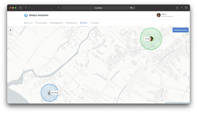

The Map tab is now full-screen, with the displayed areas:

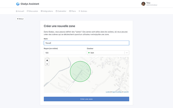

You can click on « Create an area » to display this screen:

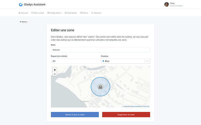

And it is possible to edit an area by clicking on the area to edit (simply):

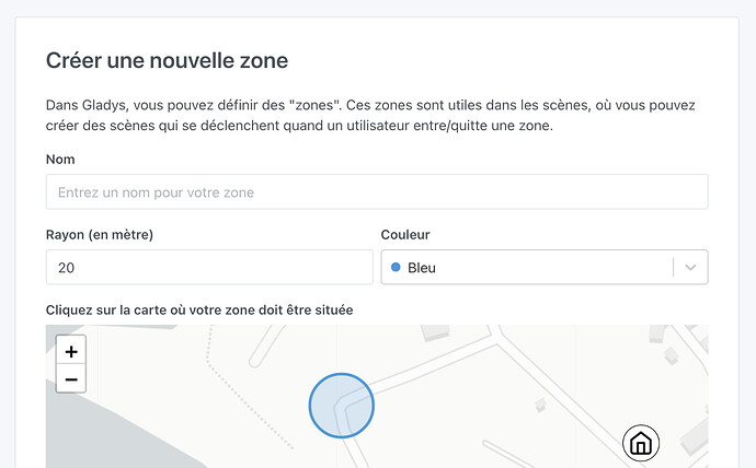

  • When creating a zone, it’s not obvious that you need to click on the map (and the error message if you don’t do it is not very clear)

Well spotted, it’s true that in the house we indicate it, I will add it!

The small hint « click on the map »:
