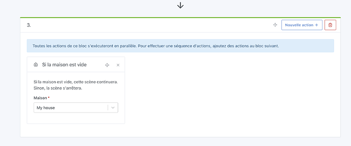

Is it just to test your presence or to check whether the house is empty/full?
If it’s to check whether the house is empty/full, you can use this block:
There is the inverse block

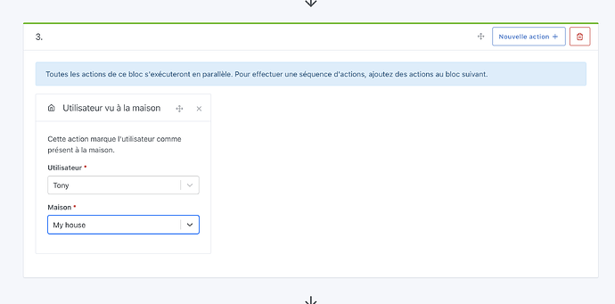

If you use LAN Manager, you can create a scene « If my phone is detected » THEN:

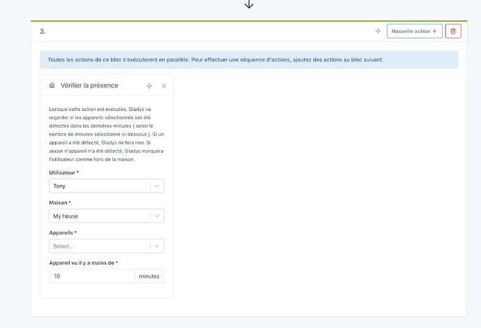

And a periodic scene that checks a user’s presence using this action:
Everything is explained in this tutorial:
(For Bluetooth but also applies to LAN Manager, it’s the same thing)
