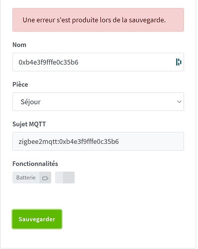

In the « Zigbee Discovery » screen, I have an error message that I can’t delete.
This is about registering my siren, the second feature (Siren) is missing, hence the registration error.
I restored old backups with no result, I also restored an old database, same thing.
Is there a solution?

In fact, it’s all my fault, I made a mistake (when you don’t know, you don’t touch!) but I touched it anyway!
After updating the binaryType.js file with the siren code:
alarm: {
      feature: {
        category: DEVICE_FEATURE_CATEGORIES.SIREN,
        type: DEVICE_FEATURE_TYPES.SIREN.BINARY,
it was correctly recognized in Gladys. However, the On/Off command did not work. I checked that it worked with the 8080 web interface, which was the case.
I then tried to replace SIREN with SWITCH, but I may have made a typo, which is why only one feature (the battery one) is left.
I’m stuck now, as I can’t get my siren recognized anymore.
Thanks for your help.

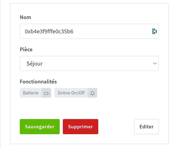

edit: I just managed to restore the situation, the error message has disappeared, my siren is well recognized, but the ON/OFF command does not work.
So, in conclusion, there is no problem?
@AlexTrovato
edit:
My siren is correctly recognized by Gladys with two of its features: « Battery » and « Siren ON/OFF » as can be seen in the screenshot above.
However, I cannot control it, neither directly from the dashboard nor in a scene with a trigger.
I confirm that the siren works well, by the way, since I can control it via the zigbee2mqtt interface on port 8080.
Thank you for your enlightened opinion.
