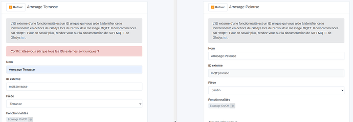

Everything is in the title: I create two MQTT topics whose external ID is different, but seen as identical by Gladys, as follows :

So, I don’t understand why they are rejected by Gladys ?

Hi @jean_bruder! The problem comes from the external IDs of your features, which are identical :slight_smile: they must be unique across all of Gladys
Hello @pierre-gilles :slight_smile:
Indeed, while rereading the excellent documentation available on the Gladys website, which concerns the use of MQTT (MQTT | Gladys Assistant), I noticed the slight difference that exists between the external ID and the feature’s external ID …
So it’s fixed, and it works perfectly :+1:
