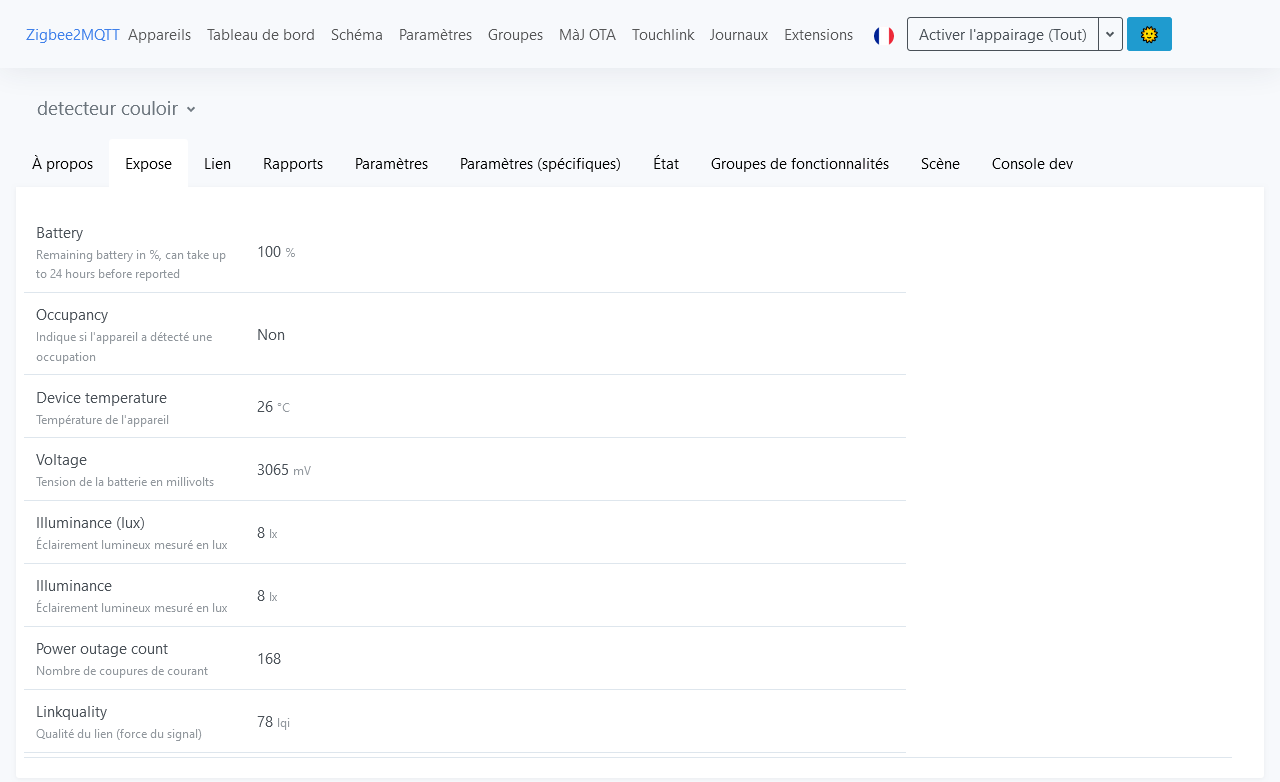

screenshot of the detector’s exposed features :

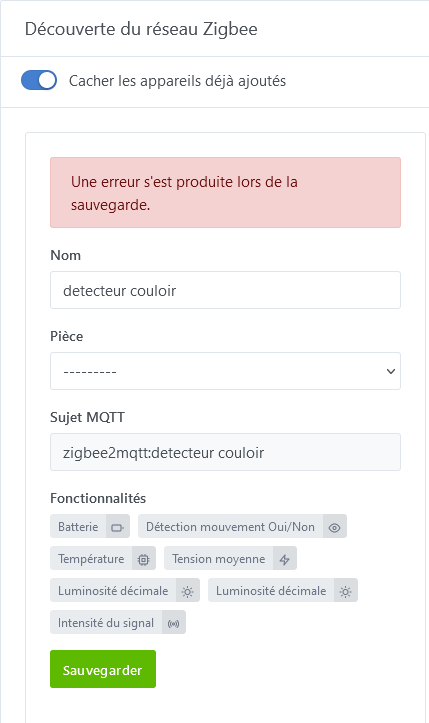

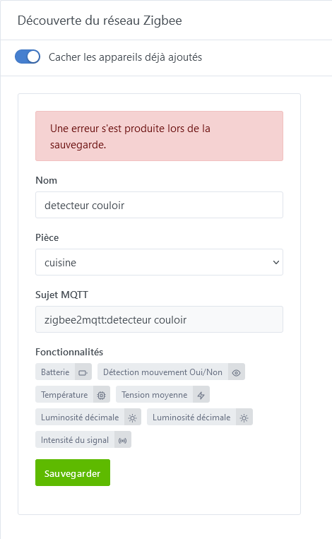

screenshot of Zigbee discovery in Gladys
is it because there
Apparently, a feature already exists. Hard to say whether a deletion went wrong or if it’s coming from this device.
