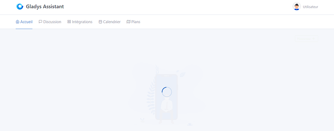

Hi @pierre-gilles and thanks for the welcome :grin:
I don’t have anything else in the Gladys logs. I tried re-adding my Zigbee module (SONOFF ZigBee 3.0 USB Dongle Plus, for reference if needed) and to collect the logs from that moment. I didn’t see anything more than the operations looping as Warnings :confused:
On the Gladys interface, it looks like this.. My user changes to User, and in the other tabs it’s impossible to display the content (except the calendar and the explanatory panel on the right in Discussion)

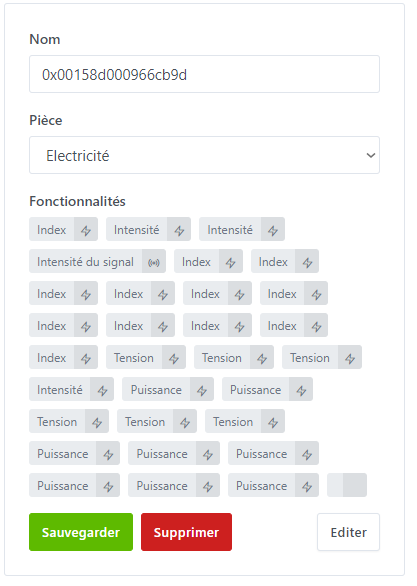

I checked and it’s the right device. But why is it trying to retrieve values for a property I didn’t ask for and that’s not exposed (and doesn’t appear in this device’s features for Gladys)?
I’m attaching a screenshot of the device in Gladys. There’s an unnamed feature, which is the relay. I wondered if it could possibly come from there. I tried removing the property from the whitelist; it does disappear in Gladys but the update is still impossible :thinking:
One point I thought I had mentioned in my previous message. I had already paired it while in HISTORICAL mode on the Linky. At that time it worked fine. I’ve had problems since switching to STANDARD (I tried deleting the device in Z2M and re-pairing it, without success)
There’s something weird, updating will just align the features.
