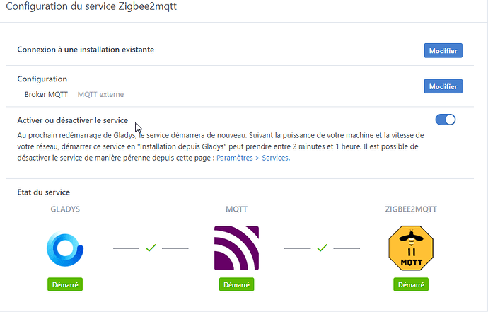

Tout semble bien connecté :
Lorsque je commande mes appareils directement sur zigbee2mqtt cela fonctionne et les logs de zigbee2mqtt ont bien l’air de publier dans mosquitto :

It’s strange because zigbee2mqtt is able to do things in mosquitto:
I can also connect to it with the MQTT Explorer client
No errors in the mosquitto logs and none in zigbee2mqtt, however on the Gladys side I have many
In the Zigbee2mqtt logs it’s not written correctly; I don’t know if that matters:
