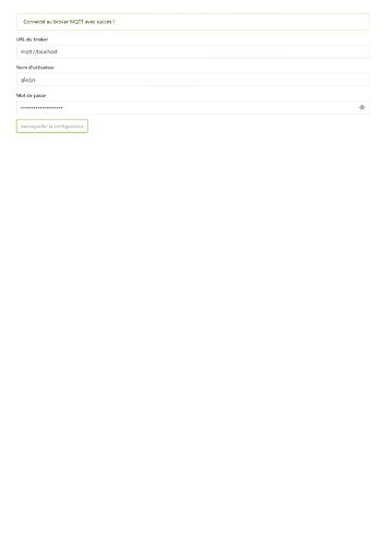

I go into the Z-Wave integration and enter the information to connect to the MQTT broker.
Then I click on scan but nothing happens
I’ll post a photo in a little while
Z-Wave integration side
On the zwavejs side, what are your values in the gateway section?
Do you know how to view Gladys’ logs?
identical to your image
no I don’t know, check the logs in Gladys.
if someone tells me how to do it, I’ll send them

In Zwave-js-ui
  • put the MQTT IP address instead of localhost in the host URL
  • enable authentication and enter the MQTT username and password
Everything works
