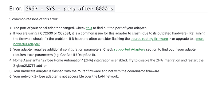

Regarding the link you shared (in the logs: z2m: Check https://www.zigbee2mqtt.io/guide/installation/20_zigbee2mqtt-fails-to-start.html for possible solutions)
There are several causes:
In any case, it’s happening on the Z2M side :smiley:
