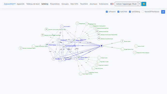

Also, I have an infrastructure that’s starting to become substantial:
Maybe your Zigbee USB dongle is reaching its limits (some have a limited number of devices). What model is it?

It’s the SONOFF, I’ll need to flash it, because I’m at 36 devices and I still have 4 to install, the tutorial given by Domo-blog is for Windows, at my place everything runs on Linux even the phone so I need to look for the procedure for Linux.
