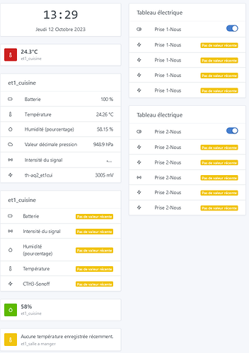

Hello
Since 4.28: Sensor state expiration, I no longer see my OWON temperature and humidity sensor displayed in Gladys Plus [ OWON THS317-ET control via MQTT | Zigbee2MQTT ]
However, it shows up correctly in Z2MQTT
Do you have any idea what the problem might be?
Thanks
How can you tell in Zigbee2mqtt that the value you’re seeing is up to date? Do you see any variations?

There are variations (I put the sensor in the fridge…)
Ok good news! Have you tried the basics (like restarting Gladys / your server)?
Otherwise, we’ll need logs because it’s hard to know blindly here

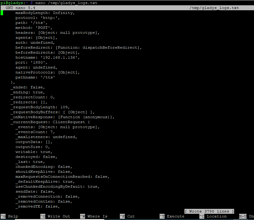

docker logs gladys >& /tmp/gladys_logs.txt
docker logs gladys-z2m-zigbee2mqtt >& /tmp/gladys-z2m-zigbee2mqtt_logs.txt
And you can upload both files here (if < 3MB)
And have you checked that the integration is working (Integrations > Zigbee2Mqtt > Configuration)?

I entered these two commands, but I apparently don’t know the correct syntax
I don’t know how to upload the two files

The two commands that @cicoub13 gave you allow you to save the logs to files.
You can find these files in the /tmp directory
If you don’t know how to retrieve these files you can always open them with nano, for example
nano /tmp/gladys_logs.txt

ok, I was able to open them with nano
Now, how do I upload the two files?

ouvrir les fichier avec nano => ok
« write out » => ok
« wrote 3798 lines » => ok mais où sont ecrites ces lignes, et où est le fichier (/temp/gladys_logs.txt)?
Sorry, I’m new to this…

This file doesn’t exist because you asked to save the log in /tmp/gladys_logs.txt
And this file is located in the /tmp directory
If you don’t know how to retrieve this file you can always run the logs and copy directly what’s displayed in the terminal.
Try first with the command docker logs gladys
