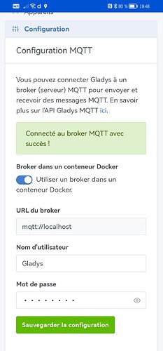

If you have the same problem as @Terdious and me, the mosquitto update causes the password to be lost.
If that’s the case, just click on ‹ save the configuration › on the MQTT integration configuration page

I think it’s saving again from the front-end. It seems the credentials are not the same between mosquitto and gladys.

That happened to me too; I had to re-enter the MQTT password on all my Sonoff devices and everything started working again. Once I removed the Bluetooth test, I had Zigbee problems so I started from scratch, and again had to update the MQTT passwords on my Sonoff devices. Usually after a full restart from zero I only have to re-enter the password that I save in the MQTT integration. But the worst thing about this problem is that I copy-pasted the same password — I hope that’s clear.
