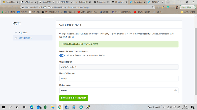

What did you put in the MQTT parameters?
I hadn’t changed it since its installation:
On Gladys side:
Use a broker in a Docker container: Activated
mqtt://localhost
ID and password
On Tasmota side:

Great!
But actually, it doesn’t work. Despite several reboots, no access to my mqtt devices :cry:
And yet:
Any other ideas?
