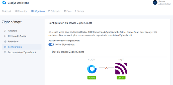

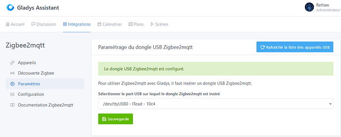

Then, I configure it by going to « integrations », then « zigbee2mqtt », then « settings », and I see that the dongle is recognized by Gladys
Problem:
When I then go to « Configuration » and switch the switch to « Enable Zigbee2mqtt », I have a red cross between Gladys and myqtt… (I specify that at each attempt, I wait for several tens of minutes as specified in the video)
Did I miss a step somewhere?
It smells like a dockerhub timeout
Can you give us the logs?
Is the MQTT part okay?
It’s not the same integration @cce66 the containers are independent.

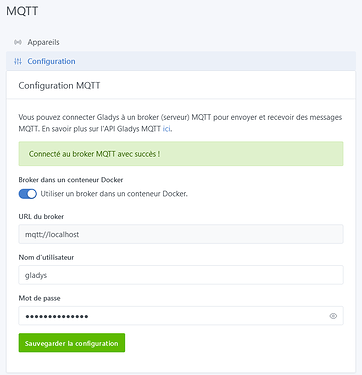

Certainly, but you still need to provide the correct information. Your screenshot shows the MQTT integration, not zigbee2mqtt.
When these two integrations are configured, there are two MQTT containers. These are two distinct services that do not influence each other.
I don’t understand, are you talking about the screenshot in my initial message? It showed my problem, didn’t it?
No no I was replying to @cce66

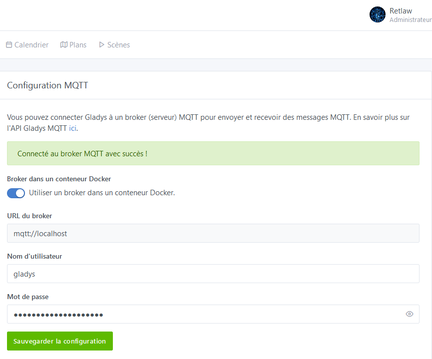

    However, in @Retlaw’s message, it seemed to me from his screenshot that the mqtt part was the issue… I have no doubt about the skills of @VonOx or his pedagogy, but when he says
I agree on the « two distinct services » and « influence » part, but nevertheless, if the « mqtt » integration does not need the « zigbee2mqtt » integration, the « zigbee2mqtt » integration does indeed need the « mqtt » integration to work???
