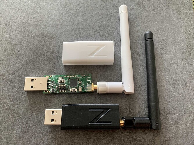

I’m looking to equip myself with a zigbee2mqtt dongle. Any recommendations?
I’m going to create my own, the components are ordered and I will have them by mid-November. But I think I will also have sensors, temperature, humidity, opening detector, etc. And if it has a long range, I will also install this system for a garage under construction that is 30 meters from my house.
I followed the advice from the site Zigbee2MQTT
If you feel like tinkering.
I’m going to add a router to increase coverage
Hmm
Do you have a turnkey solution? :stuck_out_tongue:
https://www.ebay.fr/ulk/itm/123940224744
Let’s see how it goes, but the description already inspires confidence. Let’s see the seller’s reputation.

Hello everyone, I received and configured my CC2531 key, nothing complicated, all my Xiaomi devices are recognized on a test Raspberry.
I am now eagerly awaiting the Gladys Zigbee2mqtt service to integrate all this.
If it might interest some of you, I found this while searching for a ready-to-use Zigbee2mqtt key.
I haven’t tested it, but it seems to have good feedback :slight_smile:
