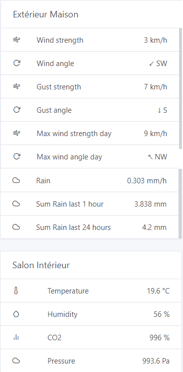

Images of the progress:
Well, I was able to make all the modifications to achieve my goal:
I think it’s pretty good for a complete weather station. Now, regarding feasibility, considering that to get there, modifications need to be made in the DB, specifically in the t_device_feature_state table:

It’s great to have this info.
What is the 996% CO2?
I’m waiting for the Netatmo heating management. :+1::+1:
Can you explain why you need this? I don’t see anything in the data you display in the UI that is in string format :slight_smile:
Oh yes, oops, you can change the unit, which I didn’t do ^^ it’s 996ppm in fact ^^

The values Wind angle, Gust angle, Max Wind angle day…
I don’t understand your question in this case.
We display values « -→ E », « <- W » … etc.
