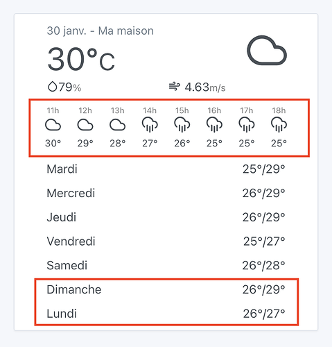

For forecasts for the following days, we’ll also have to do a little workaround, because until now we had a « per day » prediction, and now we only have « 3-hourly » forecasts.
But that’s not the same thing! When we see « 26°/27° » in my screenshot, does the number on the left correspond to the day’s lowest temperature and the one on the right to the highest? If so, we need to compute that by iterating over the day’s 8 predictions.
