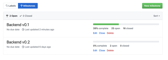

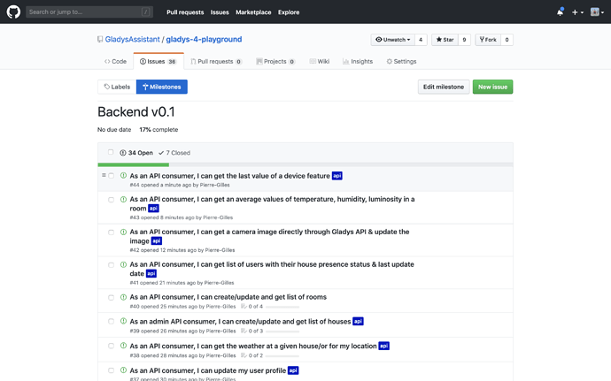

Well, I just created a fairly exhaustive list of the remaining tasks to be done before having a first minimal functional version of the Gladys 4 backend.
https://github.com/GladysAssistant/gladys-4-playground/milestone/1
This milestone does not include:
  • Work on the front-end
  • Work on the API for the pods
  • Work on the service side
I created this milestone to list all the remaining tasks to be done (both code and documentation) before we can work on the services.
The frontend will continue to be developed in parallel, even if for now my personal focus is on the API.

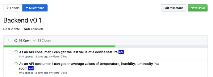

Small Gladys 4 progress update :slight_smile:
Backend first milestone progress
The backend v0.1 milestone is progressing well, we’re at 54% of tasks completed. I added a few todos along the way, but I think once all the tasks are done we’ll already have a minimal backend that does the job.
