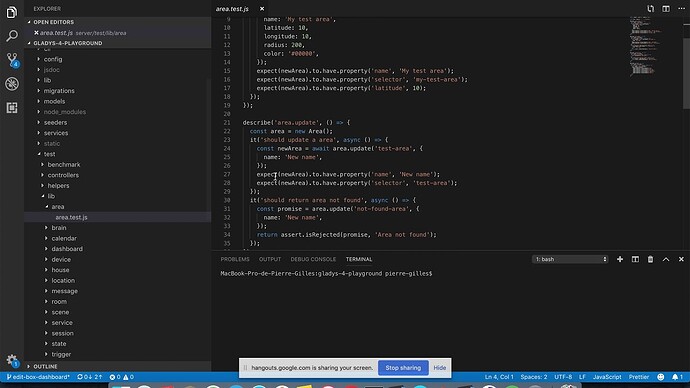

Following @NilkOne’s request, I will make a call this weekend with anyone who wants to show you how to install Gladys 4 on your machine, and how to develop for Gladys 4 :slight_smile:
As I recently announced, it’s time to migrate/develop Gladys 4 services, so this is the perfect time if you want to help!
I suggest this Saturday, May 18th at 9:00 AM French time.
Who is interested? :slight_smile:
:warning:Warning, this call is intended for an audience that already knows how to program, and already has a functional Node.js 10 development environment on their machine!

I’m setting up my laptop in the meeting room and I’m here :slight_smile:
Would a Hangouts link work for everyone?
@pierre-gilles OK for me
It’s going well! @pierre-gilles
@pierre-gilles Ready ! :wink:
Hop!
[Edit]: link removed
The replay of the call is available on YouTube!
