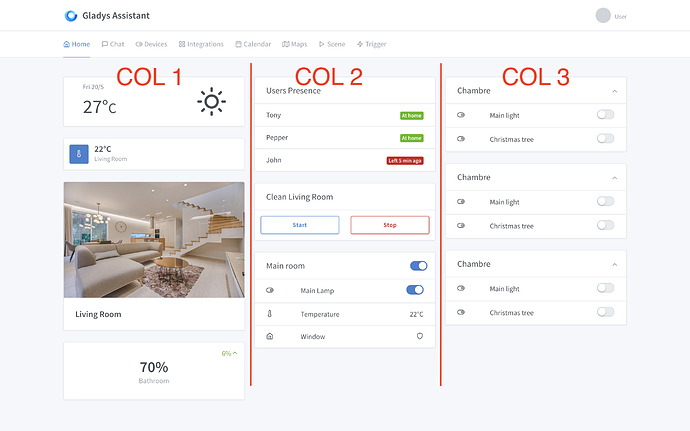

EDIT curiosity: Will it be possible to have boxes that take up 2 or 3 columns for boxes that take up space, like the calendar?

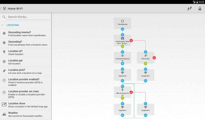

I was thinking about something when I was making my scenario on Android. Would it be difficult to have « graphical » scenarios like automations on Android?
Well, I have a lot of ideas but unfortunately I don’t have the knowledge :hot_face:

This is not currently possible, but your idea is interesting. Currently, what I have done is a system of 3 clearly separated columns. Fixed in width and infinite in height:

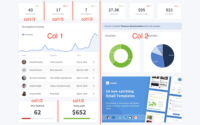

After that, if we look at the template I use, they have a different grid.
They only have 2 main columns, and inside they cut:
It would be possible to do that, but in my opinion, this kind of dashboard is much less beautiful in reality than in mockup :stuck_out_tongue: Let me explain:
To divide your column into 3 like they do, you need to have 3 similar boxes to place. Let’s say 3 temperature boxes. Same for dividing into 2.
And if you only have « wide » boxes, then your screen is only divided in two.
What we could do is give the user some freedom to have 1, 2, 3, 4 columns, and then to cut again inside each column. However, this remains quite a large development to make a « recursive dashboard builder ».
I keep the idea in mind and I will look into it, but I’m not sure it will be a project for the alpha.

Hello! I’ve talked about this several times and personally I’m not a fan of this kind of editor, I don’t find it very user-friendly.
I find that it’s a very « programming » approach that speaks to us but not to non-programmers. And above all, visually it quickly becomes a mess.

No problem and your point of view isn’t wrong :slight_smile:

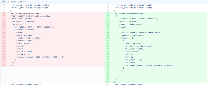

While looking at the ongoing PRs, I realized that a lot of code modifications were due to file formatting (example below):
Wouldn’t it be possible to add a linter, or a configuration for each IDE, to avoid this?
For info, at work, on my current project, we use Husky, which allows checking the code before each ‹ git push ›. In short, it runs the tests and the linter on each ‹ git push ›, to prevent everything from breaking :wink:

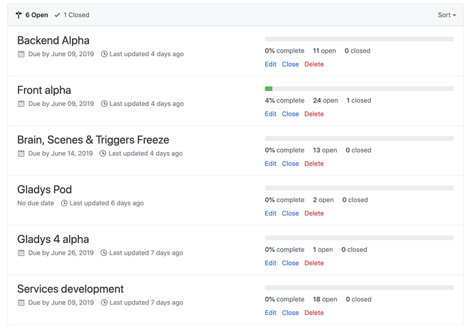

Is there a roadmap document with all the dev / evolutions listed? (by you and community requests) then details of those that are planned? as well as votes?
or are we only using GitHub issues?
This is already the case, and I can assure you that I am quite extreme about it :smiley:
You have a .eslintrc.json file for the server, and the front.
Here it is a .json file, indeed it may be missing an indication for this type of file, I will check.
I’m not a fan of pre-commit/pre-push hooks, it doesn’t encourage a frequent commit/push rhythm (if you have to wait 7 minutes to push, you do it less often). It’s quite controversial as a practice.
For me, as every push is necessarily on a PR, it’s on the CI side that it must fail and indicate that the code style is not good. After that, it’s up to the developer’s discretion to run the tests locally before pushing, if he doesn’t do it, tough luck for him, he will see on the CI that there are linting errors and he will have to correct them so that his PR can be merged :slight_smile:

Yes! You have 70 issues on GitHub, each issue is a feature to develop.
For the roadmap, it is higher up in this topic, but it is also written in GitHub with 6 milestones created with each a release date:
@Pti_Nico: After looking into it, linting .json files isn’t straightforward. I added an ESLint rule to ensure JSON files are properly formatted, but I haven’t found anything to validate indentation, for example. If you know of any ESLint library/plugin, I’m interested.
One solution could be to convert these files to .js, but I’m really not a fan of this approach (because then it counts as « lines of code » even though it’s configuration). And especially for translation files, this prevents us from using automatic tools like POeditor that consume JSON.
[Edit]: I was already using Prettier, but it wasn’t enforced. In terms of style, it’s stricter than my current config, so I set up Prettier on the backend and frontend. Normally, we shouldn’t have any more issues.
Normally, if you configure format on save in VSCode, your code will be clean with Prettier and will pass the CI :slight_smile:
