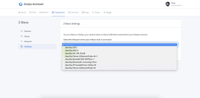

First connection, nothing configured:
Configuration of the USB port to which the dongle is connected:
Scanning in progress:

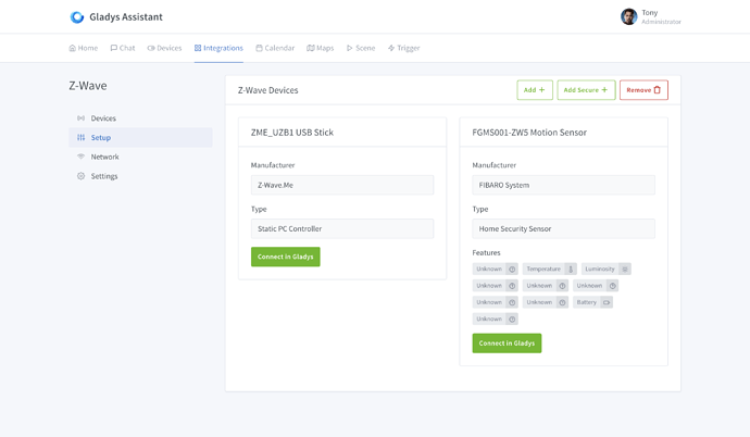

List of retrieved devices:
To add a device to Gladys, you need to click on « Connect in Gladys ». The device will be added to Gladys and will appear in « Devices ».
Devices are not added to Gladys automatically; it is up to the user to add a device!
