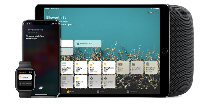

Let’s take an example, Apple Homekit, which decides on names like « Front door », « Dining room light », etc.?
I find it very cumbersome to force the user to name each device feature one by one… And is it useful? I don’t think so.

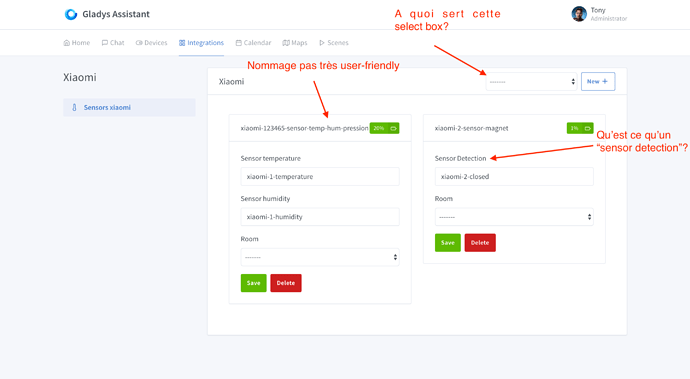

To better understand:
Here you have written Temperature, which is the name of the feature linked to the device.
So, you would like to have the name of the device and, each time on the right, the values of each feature?
It looks nice, indeed. But in this case, it’s a view of features, not devices.
Couldn’t you have both Temp and Humidity measurements on the same line, huh? :thinking:
If I take the example of a lamp, it makes less sense to have one line for on/off, another for color, and another for dimmer.
Hence my feeling that one line per device is « better ».
And from a pure tech perspective, you pass your device into a displayDevice function that is capable of generating the line in question based on the different features of the device.
