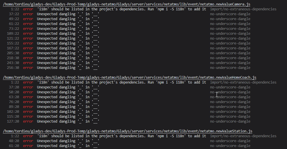

I have this error on ESLint. For the first line, I donât understand because I installed i18n directly under
/server. I thought it would be propagated⊠Do you have any idea (itâs the first time Iâve installed a dependencyâŠ)?For the following lines, I understand that itâs just ESLINT that prohibits these characters, can we manually assign it new rules? Are we allowed to do that? And if so, could you point me in the right direction?

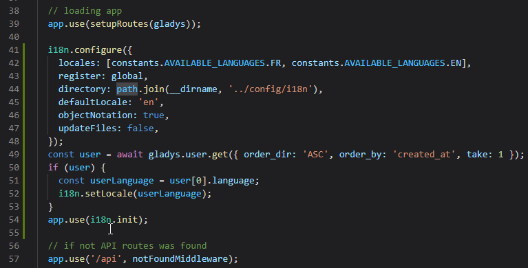

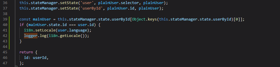

Second point: For the translation language, by default « EN », then I use the language of the first user created at Gladys startup. For the moment (I suspect we wonât do it this way in the long run), I use user.update and user.updateBySelector to update the language (just in case) of i18n. Newly created devices are then created in the new language.

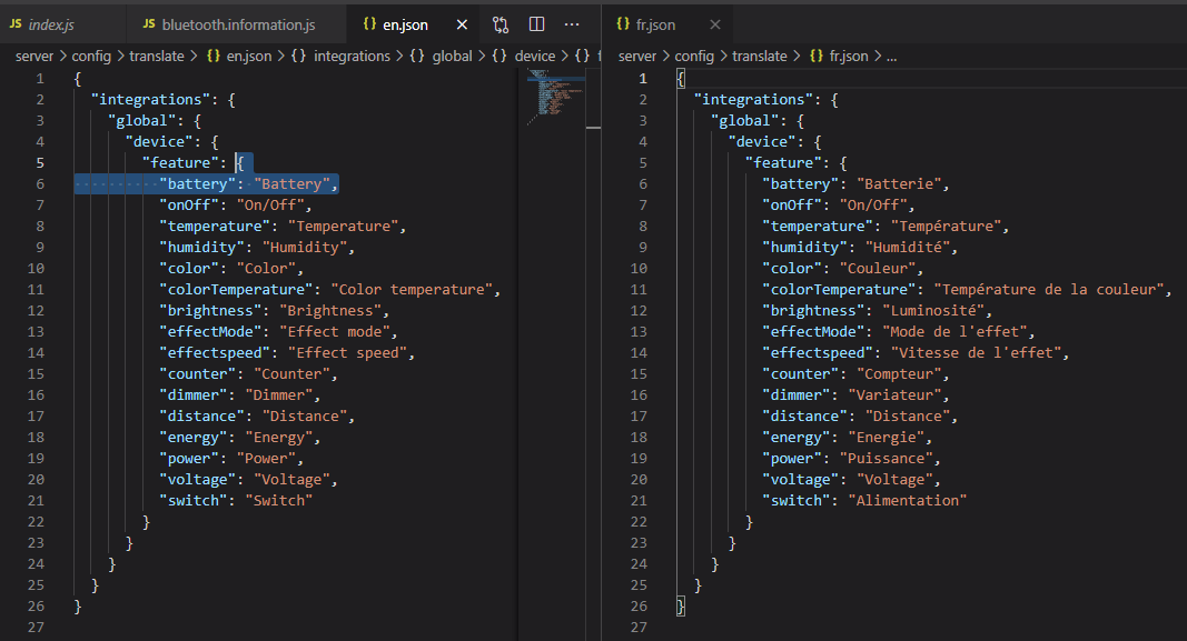

Config folder:
File /server/api/index.js:
Files user.updatexx:

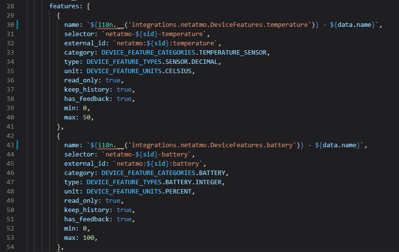

Example of use:

We agree that it is not the name of the device itself that we want to translate, generally these are already named in the API from which we retrieve the devices. For the first use case I saw, it is rather the features that are named by their category/type. All integrations name the features in the DB as « [name] - On/Off », « [name] - humidity », « [name] - Color temperature », « [name] - Power », etc. So for many of these translations, they are the same? What is the point of duplicating files for each integration?

I agree with @Terdious on this one, we need to share feature translations.
So for many of these translations, are they the same? Whatâs the point of duplicating files for each integration?
None, indeed if itâs the same translations, we can use the front-end files in the back-end, or vice-versa. I didnât know exactly your use case!
