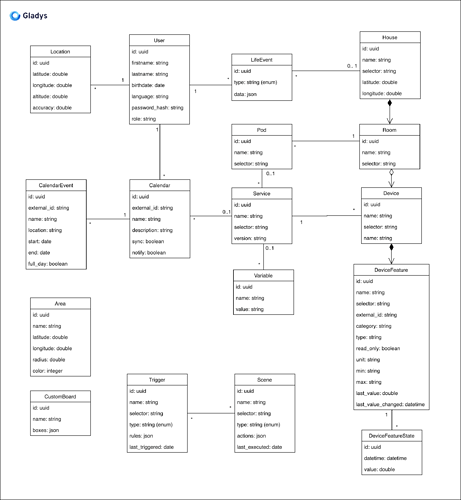

I just finished a first version of the database modeling :slight_smile: Let me know what you think, there might be things to change/forget. Let me know!
