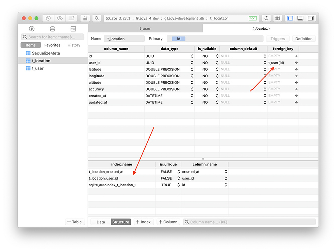

Wow, indexes + foreign keys with Sequelize is awesome
That’s so heavy :open_mouth:

If you are looking for a good tool to explore SQLite databases, I recommend TablePlus:
Or sqliteonline.com for those who don’t want to install anything :stuck_out_tongue:
