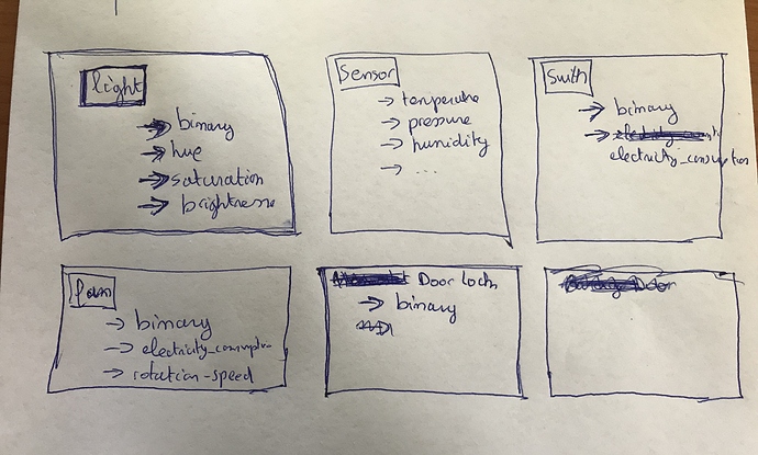

After that, I like the idea of types more fine than just « binary », « multilevel » and « color ».
If in the idea we take a quite general category + a sub-category (to be seen for the naming, I find that naming it « type » is more coherent), what do you think of this schema? (I just drew it)
(sorry if it’s hard to read, from left to right « light », « sensor », « switch », « fan », « door lock »)
What we just need to do after that, is that for each pair (category/type) we have a function that returns the kind of button to display, but it’s not very complicated.
You didn’t say what you thought about my schema!
I admit I don’t fully understand everything here ^^
Isn’t « Parameters » redundant with « subcategory »?

I think the best way to define all this is to look at real cases!
Excellent case!
So, what category would this device fall under if we consider that the category is included in the device?
1/ I’m not a fan of splitting a device into 3 devices, it’s not logical according to our definition « a device is a physical peripheral ».
2/ If we give it a category like « bridge » for example.
A « binary » type deviceFeature no longer makes sense: is it to turn the gateway on/off? Or to turn on the gateway’s light?
So, we come back to needing to add an additional category to deviceFeature to indicate « this feature is for light management ».
PS: When I told you that the modeling part is 80% of the work, I wasn’t joking :stuck_out_tongue: The code is nothing!
In the « weird » category, there’s also the Fibaro FGMS-001 (in Z-Wave) which acts as a motion detector, temperature sensor, light sensor, and vibration sensor, I think :slight_smile:
Mmm ok :stuck_out_tongue:
Too bad, I liked the idea of putting the category on the device, but it restricts us too much…
So we agree, we keep the category + the type on the DeviceFeature?
I admit that in terms of naming, I prefer « type » to « sub-category ».
I agree that it’s cool to have more detailed types though!
So instead of having:
  • binary
  • multilevel
  • color
We would have richer types:
  • binary
  • brightness
  • temperature
  • color
Like my schema above! Quick reminder:

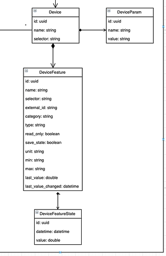

Another point we haven’t discussed is the famous device/deviceFeature parameters!
Z-wave has device-specific parameters, and currently, these are mixed with deviceFeature (not great).
We could add an attribute in deviceFeature to indicate that the feature is a parameter.
Problem: if the parameter is a string, how do we handle it?
Example: if we want to store a camera’s URL in Device/DeviceFeature, for example.
This could be another table…
Another unrelated idea: Add a boolean in DeviceFeature to enable or disable the historical tracking of values (very practical for certain detectors that send values and for which we don’t necessarily want to track the values historically).
(I’m dumping my ideas like this)
Small model of what this could look like:
I thought about that but it doesn’t work in the case of z-wave! It sends the parameters one by one as if they were features, and so you would need to perform a heavy operation of:
  • SELECT Device
  • Add the value in the JSON
  • UPDATE device
Whereas here it’s in one operation!
And above all, I prefer the relational aspect for everything that is exposed to developers, it must be strict in the DB otherwise it’s a mess in 30 seconds ^^
The rare places where we will do JSON in the gladys DB is for very specific reasons!

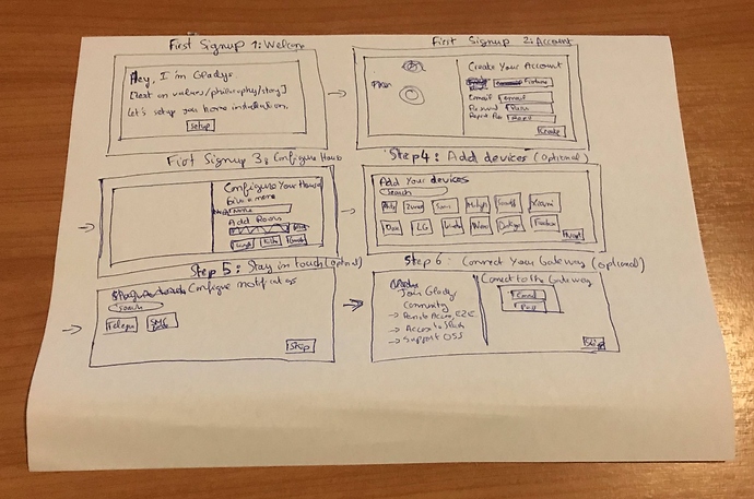

Well, I’ve switched to wireframe mode and worked on the onboarding process.
So far, I’ve identified 6 steps:
1/ Welcome: Gladys welcomes the user. A quick reminder of the project’s philosophy, values, and history.
2/ Local account creation: name, email, password & password repetition
3/ Home configuration: Recording the name of the house and adding rooms
4/ Adding devices: The user adds their devices. They have a search box and can select the integrations they want to configure. (Optional)
5/ Notification configuration: To stay in touch with Gladys, Gladys offers to configure communication services: Telegram, SMS free, etc.. (Optional)
6/ Connection to the Gladys Gateway account: Presentation of the Gateway, and connection. (Optional)
If you think of other steps, don’t hesitate!

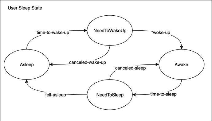

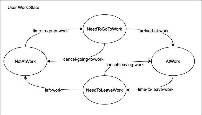

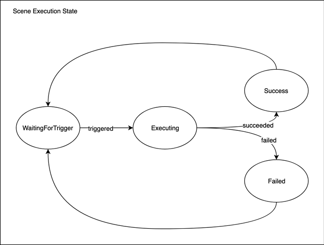

Yesterday and this morning I worked on defining the states / state transitions. This may seem like a trivial subject, but it’s a real reflection.
Each entity in Gladys is a finite state machine with several states and transitions between each state. These states and transitions need to be defined and named.
User sleep
4 states:
  • Awake
  • Asleep
  • Should wake up
  • Should go to bed
Here is the transition diagram. Each transition corresponds to an event in Gladys, a « trigger » on which any scene can be connected.

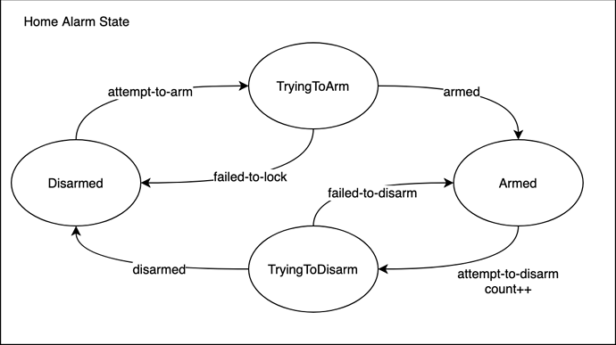

In Gladys 4, I am introducing the concept of a home alarm so that Gladys can finally be a clear and proper alarm center.
Like sleep, 4 states:
  • Armed
  • Disarmed
  • In the process of arming
  • In the process of disarming

Scene execution
Sun state
Work presence

Yes you’re talking about scenario, the graphs are the Flow between the states.
And there is indeed the armed state for the alarm.
Actually, in this diagram, I had assumed that the « activation » part of the alarm was more on the scenario side. However, I think you’re right, it would be worth putting it there, at least to define the names of the different transitions :slight_smile:
Thanks for the feedback!

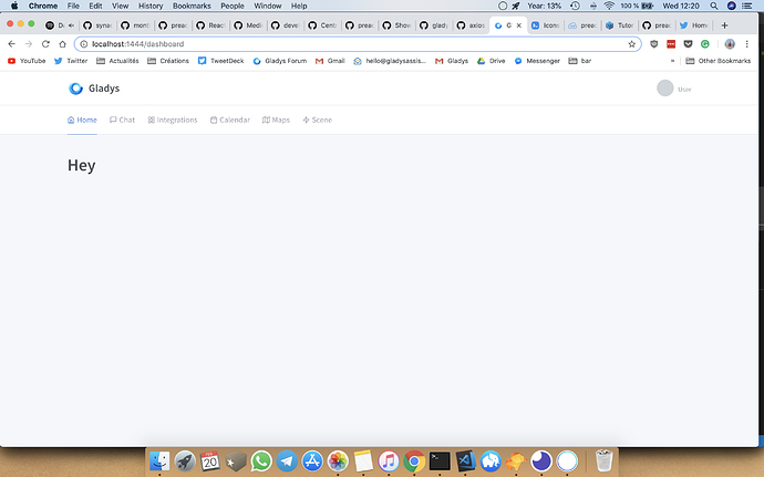

Today, a lot of work on the frontend, I’m in the thick of it :slight_smile: Here’s a little preview, any feedback/ideas for the navigation bar organization I’m all for it!
For the login I’m hesitating between two versions…
Let me know what you think!
With logo for login for me. :stuck_out_tongue:
By the way, you don’t rename Gladys Assistant in the dashboard either?
I think I’ll go with that, everyone on Twitter is unanimous :stuck_out_tongue:
Well spotted! :slight_smile:

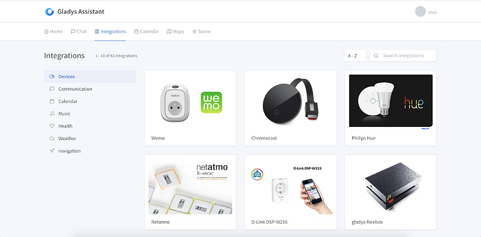

New page, integrations:

Each Z-Wave device has parameters (e.g., refresh rate, light sensor sensitivity, intruder detection threshold, etc.) that you can adjust. I proposed a DeviceParam to store these parameters, which, for me, are not really features, they are parameters.
This DeviceParam could also be used to store other things, for example: the credentials of an IP camera, or something else.
Do you see the idea?
