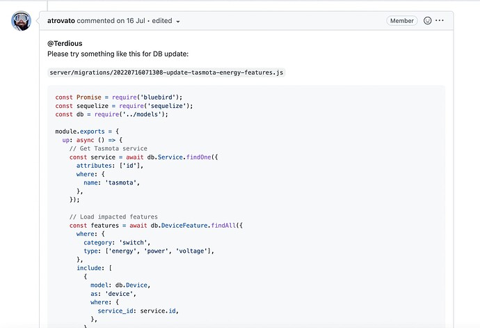

I was referring to this message from @AlexTrovato:
Currently in the PR there are no database migrations to fix the data already entered in the DB with the wrong format, so someone who adds this type of device ends up with « hybrid » data, and on their sensor charts it’s wrong (there will be a jump between before and after, right?)
What do you think?
My bad,
In this case I’ll look into doing that!! Indeed, I didn’t intend to touch the old data but for the graphs it might indeed be necessary ^^
The code that @AlexTrovato proposed is very good :slight_smile: You just need to add a concurrency to Promise.map as I suggested in the PR, and that should do the job. Test it afterwards!
