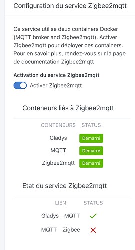

I have just installed Gladys to use Zigbee2mqtt. I followed the instructions. But the MQTT > Zigbee connection is not happening.
I searched the forum and performed the steps I found, but no connection is established.
