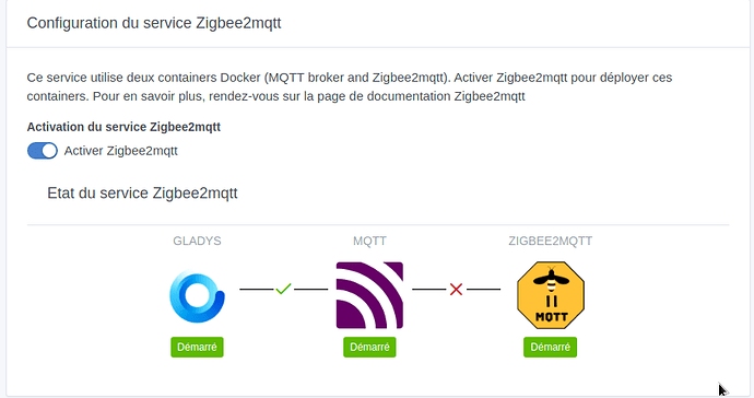

On the Dashboard side, I only have this:

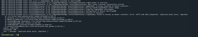

So I went to look at the Gladys logs and found this
But I have no idea how to fix this error.
Finally, I deactivated Zigbee2MQTT, restarted the RPI, reactivated it, and this error seems to be fixed.

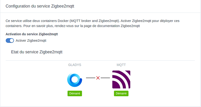

However, this time I have this…

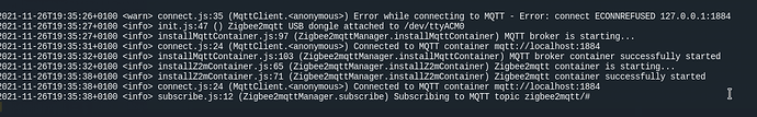

Nothing unusual in the logs (I think)
But it’s impossible to check « Allow Association » and discover new devices
I had this bug not long ago with another container, same thing after restart no more problem (it wasn’t related to gladys)
Yes, I thought I saw while searching a bit that it was a fairly common problem with Docker.
However, regarding the second issue, it’s impossible to enable « Allow Association »
What could this be from?
